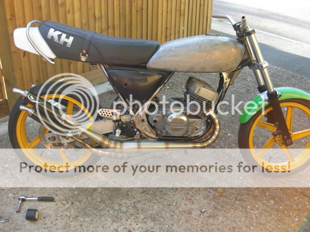

It's not quite like that :D it's a KH350 with KR1s running gear, here's the mock up for making the pipes

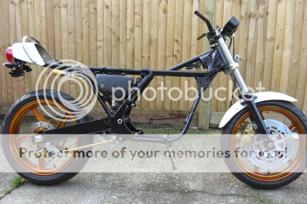

Here's how far I've got with putting the finished article together.

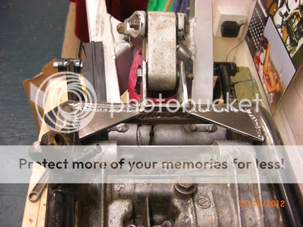

But you need one of these on the back...
Have you mounted the shocker fixing the same way Cabbie did on his KH400 ?

Don't know how Cabbie mounted his shock but this is how I did mine.
