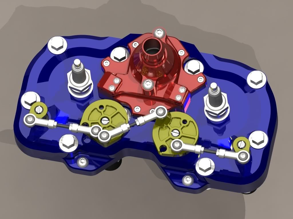

After seeing the rgv/rs cylinder heads stan stephens is selling on ebay I got to thinking if a similar design could be used to make a replacement head with: removable combustion chamber domes for easy tuning, o-ringed mating surfaces, improved water volume and flow (this I have no idea about as the original seems to have a pretty good volume already) and that could be fully machined so as not requiring a casting stage like the original.

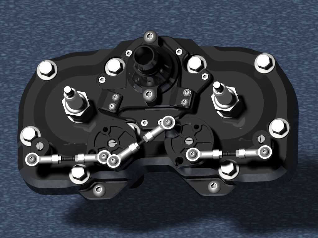

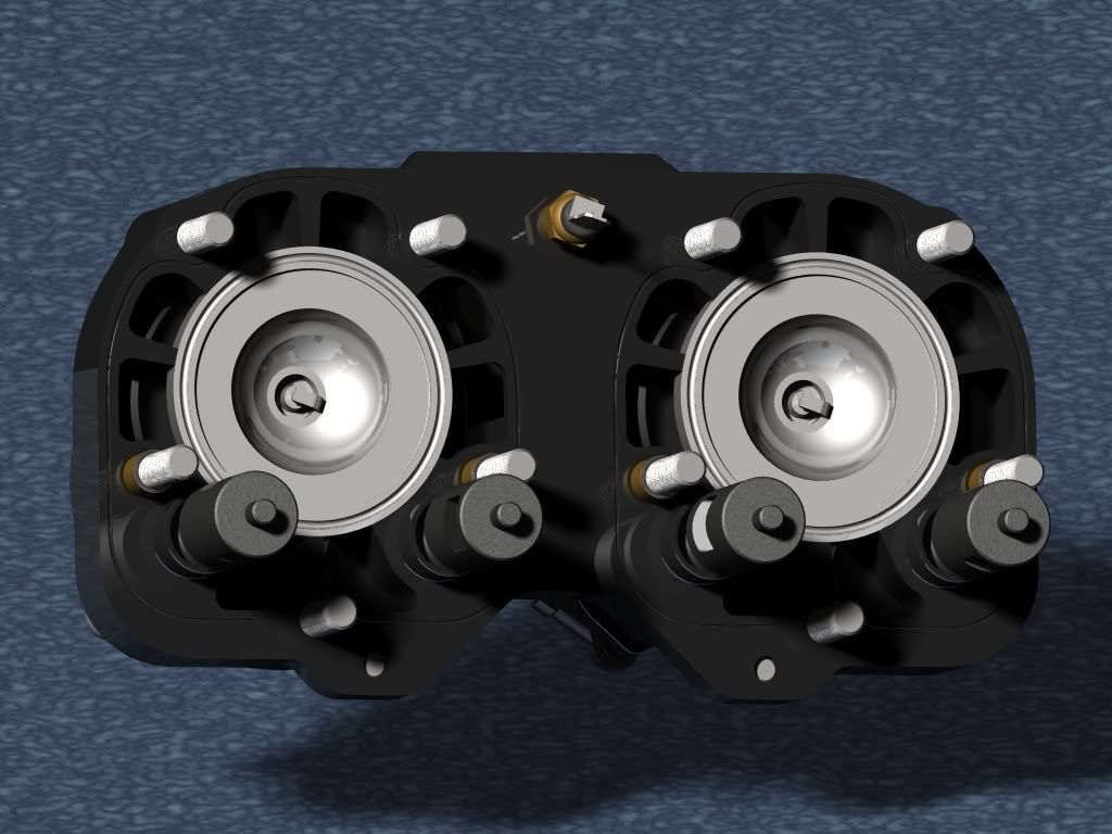

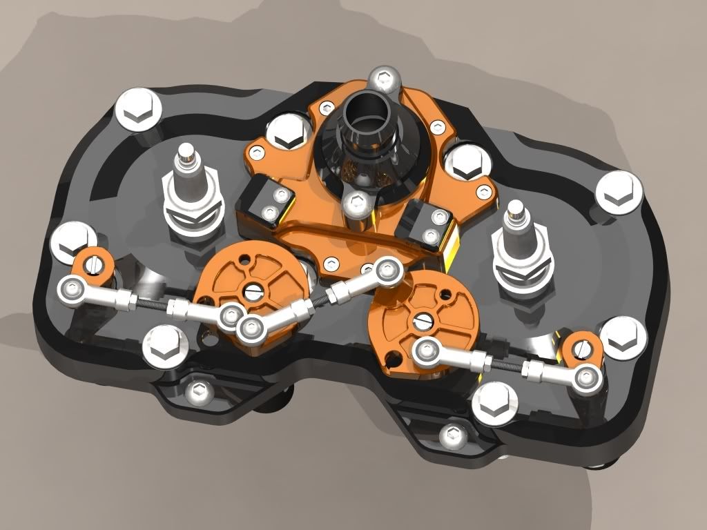

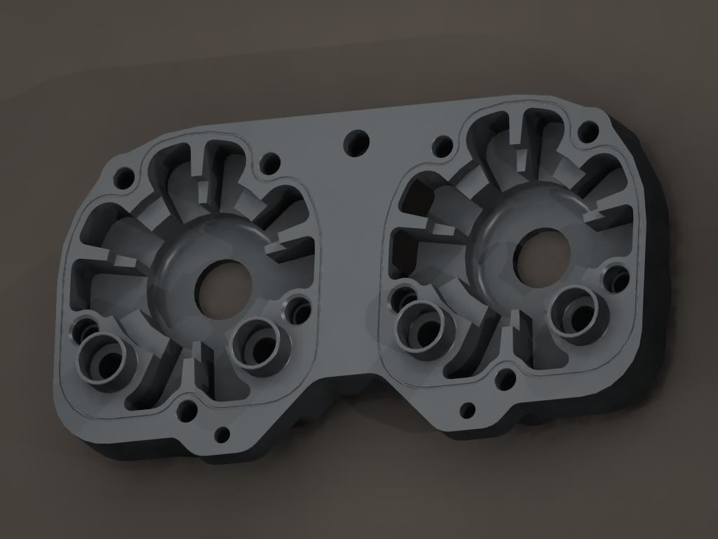

Here are the renders I’ve done for the assembled head, the main head block to show the water channels and a few colour variants on the anodised parts.
I’ll be happy to answer any questions posted but as for actually attempting to make this as the costs would be massive to have it commissioned, it all depends on what my next job turns out to be, hopefully with access to an automated workshop but that’s up to her majesty (that doesn’t mean prison in case you were wondering).
