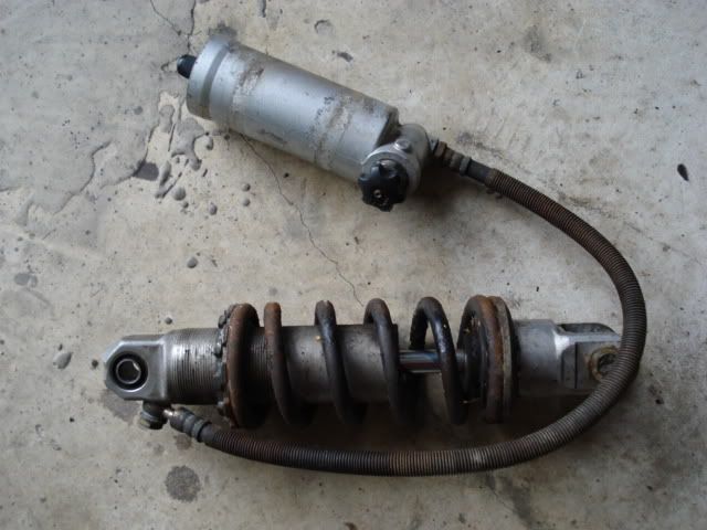

another query for you all,
my current bike is an 06 zx6r so the new arrival of my KR1s is presenting me with all kinds of new issues.
The rear end on the bike feels a little saggy to say the least, when you compress the back end of the bike it returns a little slower than i would have expected almost as if the rebound damping is set to high, but i imagine it is more a case of 18 years of use,

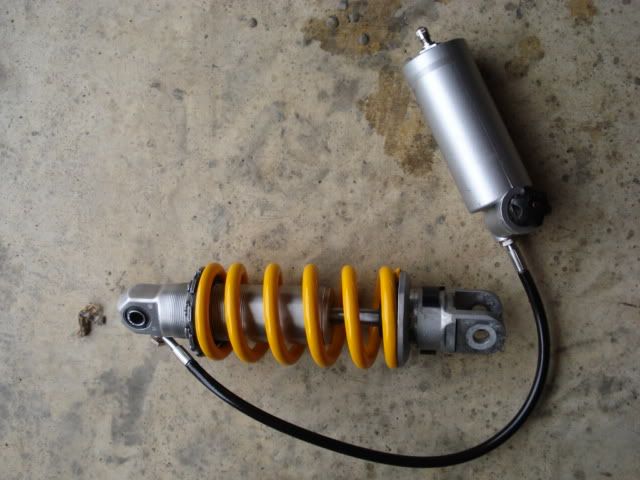

have had the rear shock rebuilt now and resprung / revaled for my weight,
had it done in the end at DPS in keighly,
well impressed with their work, have added before and after pics,
