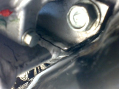

What a bad day.
first i found some gear oil under the crankcase.
left side under the shift mechanism cover........
and then i saw a very long crack (more or less from side to side) in the RHS
bottom engine mount.
last year there was no crack.
Words fail me.

On the outside of the motor? If so that might be just a leaking seal/gasket and not a major problem.dirk wrote:What a bad day.
Thats a very normal crack in any frame of the early 90's. It's due to sloppy tolerences from the factory. Measure the width of the engine and frame mount and get a shim made to remove the slop between them.and then i saw a very long crack (more or less from side to side) in the RHS
bottom engine mount.![]()
Words fail me.
Two choices, if the weld is only partally cracked then drill the tip (down to the un-fused land), or get it dressed out with a drimmel and rewelded. If its not too far gone and the mount is still attached to the frame

mine has no cracks but its a bloody wonder!! bottom mount must of ha .25 mm of slop!!!!!! even when torqued up the spacer was able to spin round easily. dirk, has your bike had diffrent cases at some stage in recent yrs! seems odd that a crack has developed in the last year when its been ok for 18-19yrs? maybe the alloy fatigues ect with age. i found that an old shim from the gearbox works perfectly for shimming the bottom mount. hth. i feel for you dirk, not nice when you have problem after problem with your pride n joy. look at it like this, only so many things to go wrong on a kr. before long it will be 100% reliable with mostly new parts!! id change suppliers/crank builder ect just to try and improve your run of luck. your supplier may have a batch of friday night special spares (bad batch/poor qc)?? who knows.

hi
the crack is to long and the gap to thick for a repair with a shim.
i hope i found an aluminium welder.
that is not easy and i think very expensive.
and then i hope i found what´s wrong wit the engine.
with my luck a crack in the crankcase and the crank seal.....perhaps barrels and pistons, gearbox
it's all ok
but the engine mount... nightmare.
during my first full rebuild i had changed the crank and the crankcase.
perhaps the "new" crankcase was a bit to small.
thanks for the tip with the shim.

Mine had the same crack, as Elf said, you can run with it.
A friend is an experienced welder and he assured me there was still plenty of strength left as the mountings are welded in enough places.
the shim doesn't repair it - just takes the stress off it.
I ran mine for a couple years like that (not clever but safe enough), repaired it month or so ago and found that the bolt (engine) hole also had cracked.
Fix engine first, probably air leak or something, welding should be cheap - half an hours work.

The only thing about welding Alloy is that the set needs to be DC, while for any other material its welded using AC (or is it the other way round). Anyway if your getting it welded, do the prep work yourselve by Veeing out the crack first as that'll save the welder time. The welding it-self shouldn't cost much at all.
