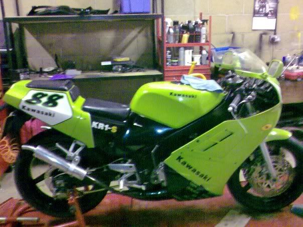

Just weeks after buying it, the engine went - crank seals failed.. Off to BDK where they advised a total rebuild.
In the mean time I stripped the rest of the bike, powder coated the frame and swingarm matt black, refurbed the wheels, replaced all the bearings, fitted a new shock and rebuilt the forks and brakes. As well as scrubbing 20 years of congealed oil and gunk off everything.
Then I threw it all back together, started her up and off for an MOT. Passed
I just want to ride and enjoy it this summer before I take it off the road and get a proper pro respray next winter. Some saving-up to do in the meantime.
Anyway - this is my smoking monster, just before we went for an MOT.
