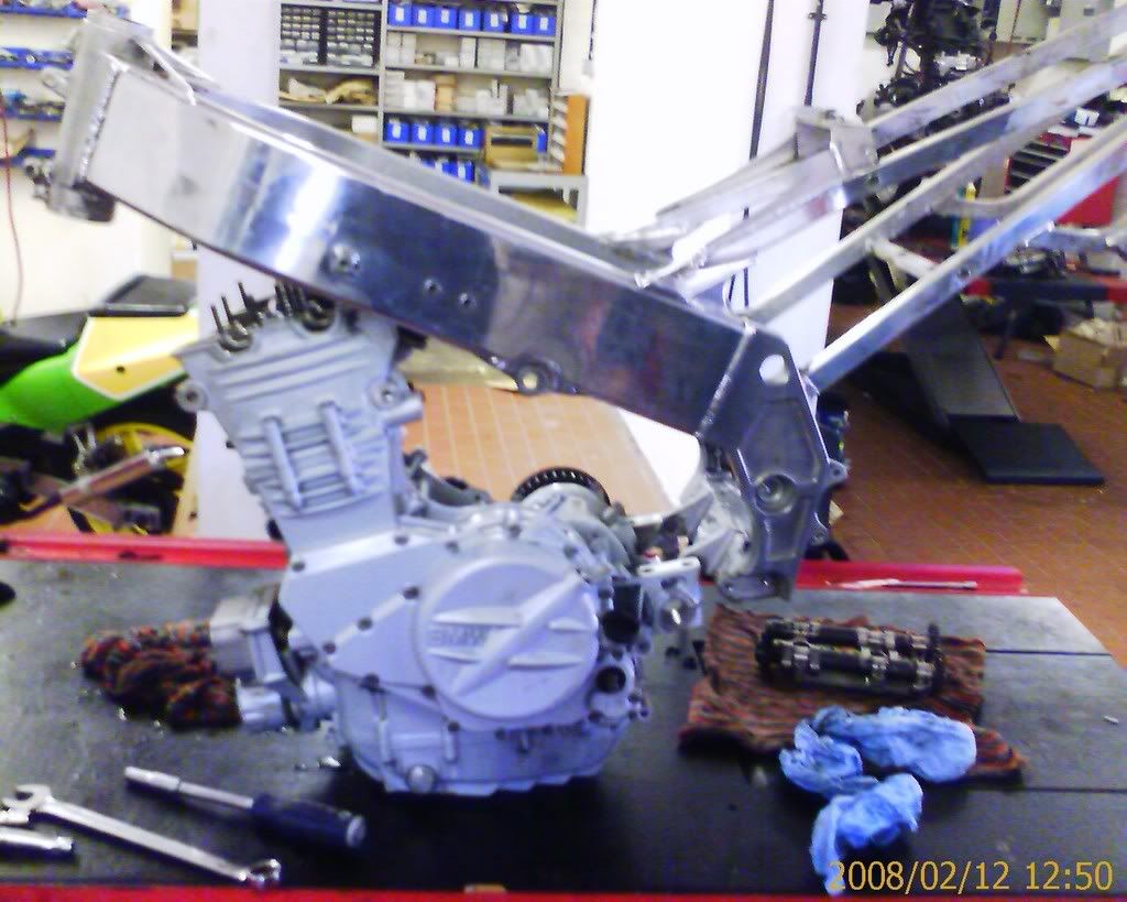

the frame spars need to b widened about 2 inch and a different mount for the rear..n possibly a zxr400 tank to clear the head...hmm got a spare one in the workshop at the mo i replaced cos of knocking(i now know its just piston slap,this engine had worn skirts,n very shallow pistons)...

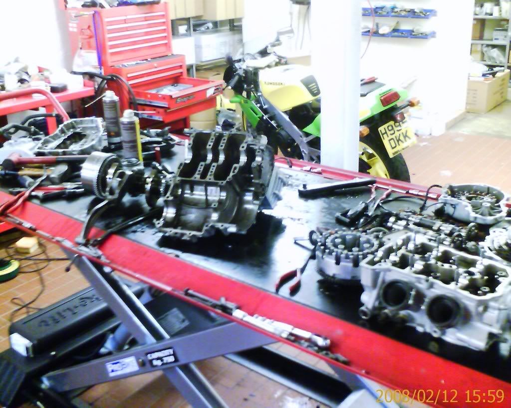

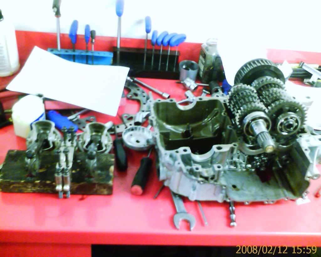

n this is how the engine looked by the end of the day......
sorry its a 4 stroke...i'd much rather put an rd/rg500 lump in...
