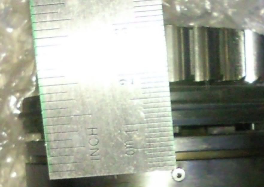

I offered up the crank to the crankcases yesterday and noticed that the right hand bearing locating Pin (not the flywheel end) did not sit in the crankcase recess. This lead me to believe that I may have the incorrect bearing fitted.
Does anyone know what this bearing part number should be.
I checked the Fiche on CMSNL, but it only list the crank as a complete assembly.
(BTW - PJ Engineering will only give you advice if you have a PJ Engineering invoice - which I don't)

Post by buzinc »
Is this the one that sits behind the drive pinion? The old one I have here, has the following stamped on if thats any help.
Koyo 83B593
Posts: 1549
Post by scooble »
yes, its the one that is behind the end crank gear.
Could you also measure the distance from the outside of the pin to the outside of the bearing face to?
buzinc
Posts: 144
Joined: Sun Dec 09, 2007 6:42 pm
Location: Next to RAF Henlow
Post by buzinc »
12mm
Gap from pin to grove 7mm
Posts: 1549
Post by scooble »
thanks for that, my pin is approx 2mm away from the groove. Looks like BDK may have messed up :(
