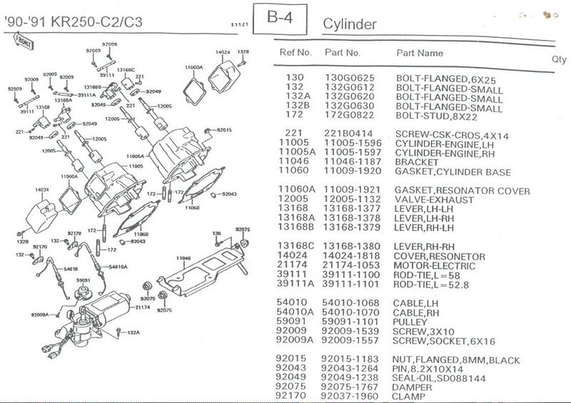

I've had all my powder coating and painting done and have got to the stage where I'm sticking the top end back on the engine (thats the only engine work I'm doing as the bottom end appears fine) but when I went to put the actual power valves into the barrels and was about to put the head on, I noticed in the manual that there look to be washer type things that go onto the power valves prior to the head going on??
I can't find mine anywhere and as the engine was apart when I bought the bike, might never even have had them.
Can anyone tell me exactly what these are and if they're just a normal washer, what the thickness of them is please?

there are dowels/pins to locate base of cylinder to crankcase
and likewise smaller dowels/pins for the head to cylinder
but the only thing to do with the KIPS valves is the seals
4x part number 92049-1238
they mount into the top side of head - theyre probably still in it
they are common seal between many KDX and KX models
so aftermarket equivalent size should be available cheaper than stock
ask HERE if KWACKMAN12 (Gary) has any sets left
