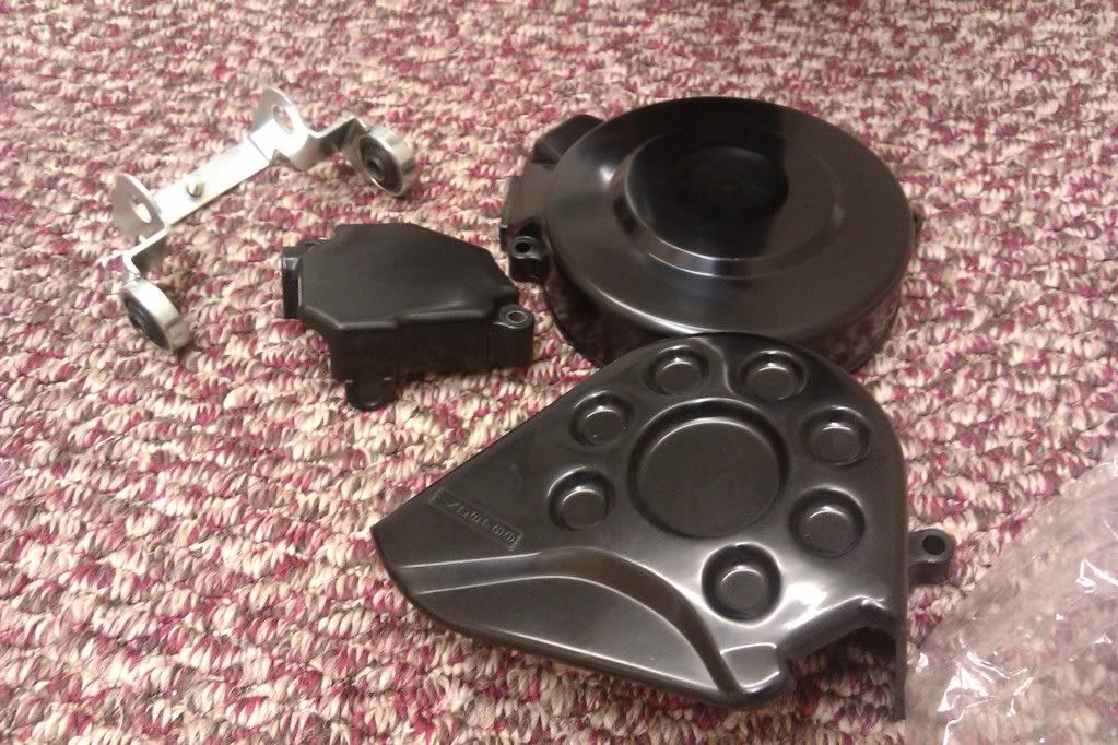

I was going to put all my NOS engine casings on and the NOS bottom exhaust bracket on, but I think it can wait until tomorrow :)

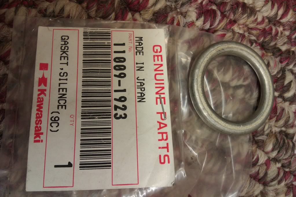

Hi Guys
Are these the correct exhaust gaskets, they look really small :shock:
... theyre muffler/silencer gaskets for the tail pipe
you need 11009-1922 for cylinders
... bet that carpet could tell a few tales
Thanks Danny I thought I was going bonkers #-o #-o #-o
