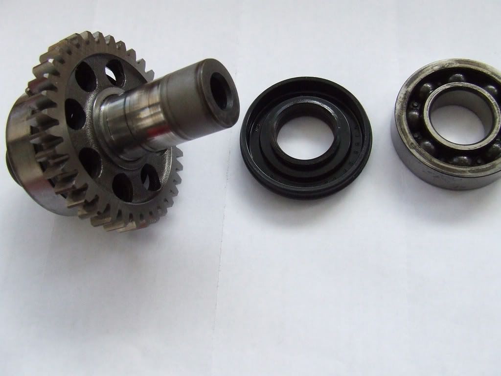

Some points before you send your crank to whoever! My crank had a stuffed centre section and the rod rubbed against the R/H crank wheel.
Having just received my crank from Graham File. He very kindly sent me the duff parts for examination.
Below is the infamous centre section. The bearings are a press fit, usually requiring several tons. My bearing simply slides off. The centre of the bearing was spinning on the shaft.
If you look at the crank wheel the big end pin (slightly left of pen) is scored or rather a furrow, making it scrap
